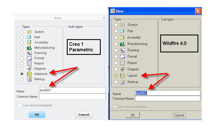

When I go to create a new Layout in Wildfire 4, the button's there for the type and the default name "lay0001" is there.
When I go to create a new Layout in Creo 1, the world get's wonky! Next to my familiar "Layout" icon is something called a "Notebook", yet my familiar "lay0001" default name is still there.

The Original "Layout" functionality is part of Pro/Notebook. With Creo 1.0 it looks like there is an attempt to rationalize the names.

You're right! They've renamed Layout Mode that's been called Pro/NOTEBOOK since time immemorial to simply Notebook. I'm sure it has the same functionality as always. I have never been a fan of Pro/NOTEBOOK (for various reasons).
However, PTC is also launching a new product called Creo Layout. It was due to be released with a maintainence build of Creo in the fall but hasn't been released yet. I can't find any reference to it through the software download links. Other new products like Creo Sketch and Creo Illustrate have been released. I have both. I cannot find Creo Layout at all though which leads me to believe it's just not ready yet.
After viewing the video for Creo Layout and going into Creo Parametric 1.0 in Notebook Mode, I can tell you they appear to be two different things. Creo Layout is supposed to be a standalone product whereas Notebook is integrated into Creo Parametric. If you compare the screens shown in the video to Creo Parametric, you see definite differences between the two products.
