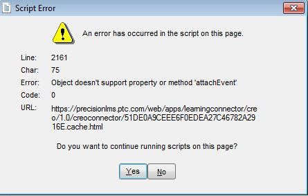

Has anyone had any luck getting the learning connector to work with Creo 2 M100 and Internet Explorer 11
I am getting a script error with a Yes No to continue.
Once I hit Yes to continue, I only get a blank window and no content.
There is a Support item available. https://support.ptc.com/appserver/cs/view/solution.jsp?n=CS181958
The changes prescribed within that document don't apply to my Companies flavor of IE11
I am awaiting response from my companies corporate IT at the moment.
Any help or suggestions beyond CS181958 ??

Clint Walton wrote:
Peter,
There might be some useful info in this thread if you haven't already seen it.
Re: Learning Connector issues (?)
Thanks Clint.
I actually posted a solution in the other thread for all to reference of what worked for us at my company.
