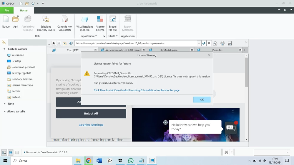

I installed the student version following the instructions but once started it gives me this error and I can't use it. how can I do it?
Translated by the Community Moderation using Google Translate.
ho istallato creo versione studente seguendo le istruzioni ma una volta avviato mi da questo errore e non riesco ad usarlo. come posso fare?

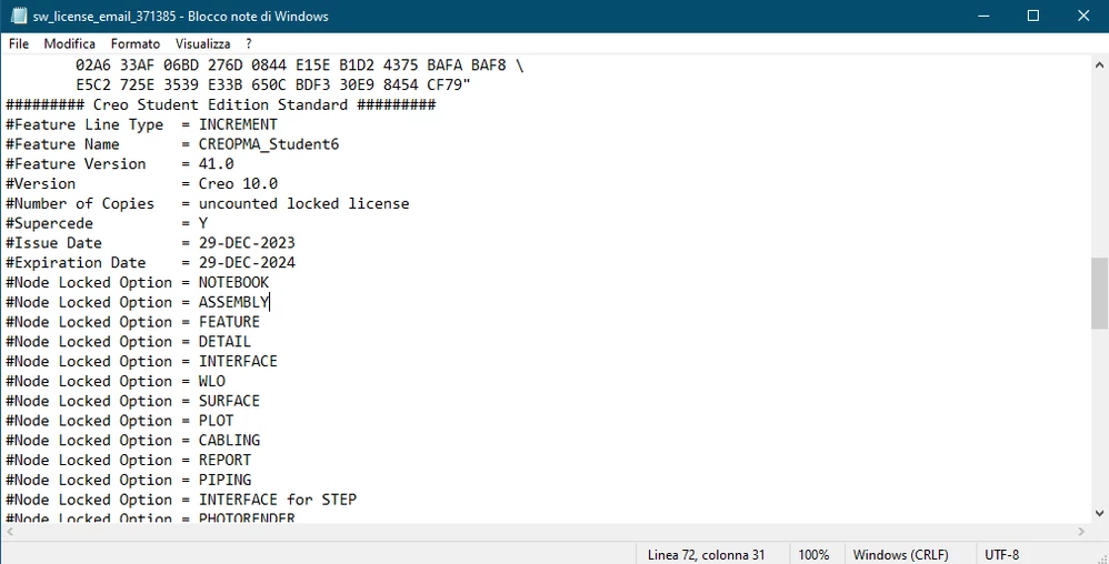

it looks like your license file does not contain license for running Creo 10.0.
Please publish the picture of INCREMENT CREOPMA_Student6 line.
To run Creo 10. please read following documents
https://apps.ptc.com/schools/references/install_creo10_schools_standard.pdf
https://apps.ptc.com/schools/references/install_creo10_unistudent_standard.pdf
November 14, 2024
@DD_12257196 wrote:
this license is valid until 29-DEC-2024. It enables you to install an run Creo 10.0 (or older) successfully.
