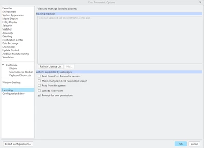

Mar 20, 2023 2:25 PM UTC
Info tab on my system is dead. Can't select it for some reason.
