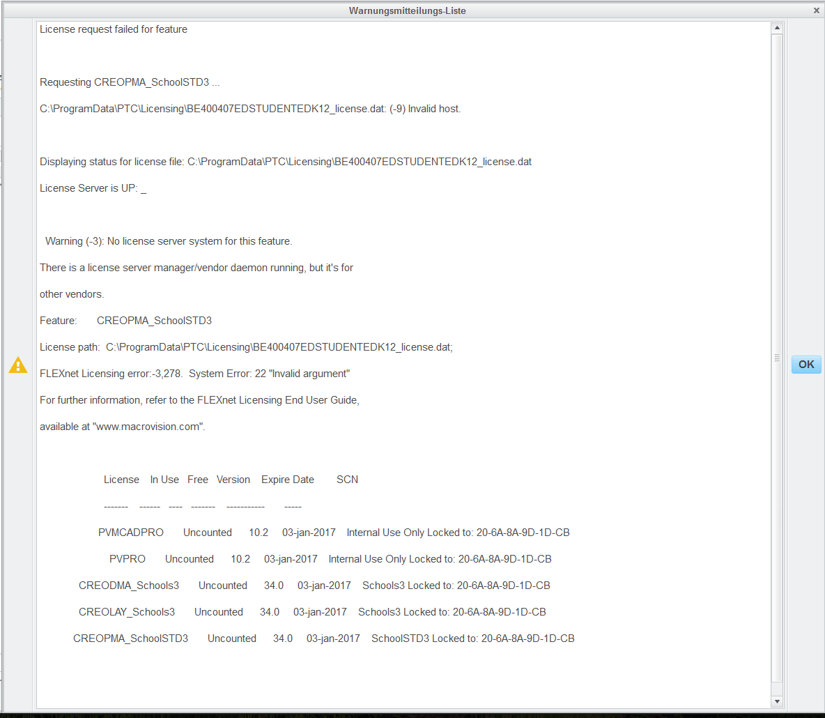

License failure
What means this and what can i do?

Looking at the message, you are not using the right NIC card address for the server.
Run PTCHOSTID and see if the NIC card matches the NIC address in your license file.

Thanks for the quick answer!
I am not able to open the file "ptchostid"
