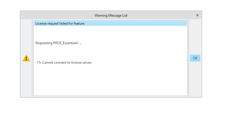

OK, I need some assistance.  After using Pro E/Wildfire/ CREO for many years I still am easily confused by the license for this software.
1.  I turned my computer off due to heavy storms in the area.  CREO 4.0 was working fine.
2.  This morning I restarted my computer, CREO failed to find the license server, which is my computer, not on the server.
3.  MathCAD Prime is on the same computer and the license is the same file, but comes up fine.
I need CREO to get back to work of projects.....  HELP.

Is this a student license or full version?
If it's the full version then is the Flexlm service started?

this is a full version, not a student version.

What is there in error message? Add a snapshot of error...

-15 Cannot connect to license server system.
The server (lmgrd) has not been started yet, or the wrong port@host or license file is being used, or the TCP/IP port or host name in the license file has been changed.
