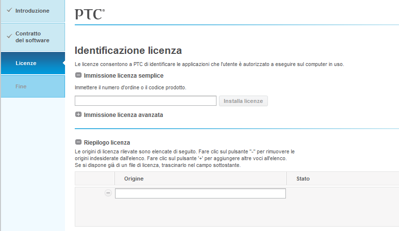

this is the problem:
1 I install creo parametric without configure the license
2 from installation menu I select configure license
3 I insert my order number in "immissione licenza semplice"  and i click install license
4 I receive on my e-mail adress the lm.txt file
5 I drag the lm.txt file in
But the software doesn't recognize my license!!!
The host ID of my PC is correct in the lm file....
I think I will contact the the technical support of my city.

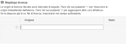

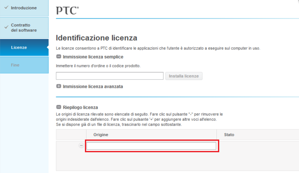

Jun 5, 2015 4:35 PM UTC
Stefano,
you have to drag your license file into Origine field.
