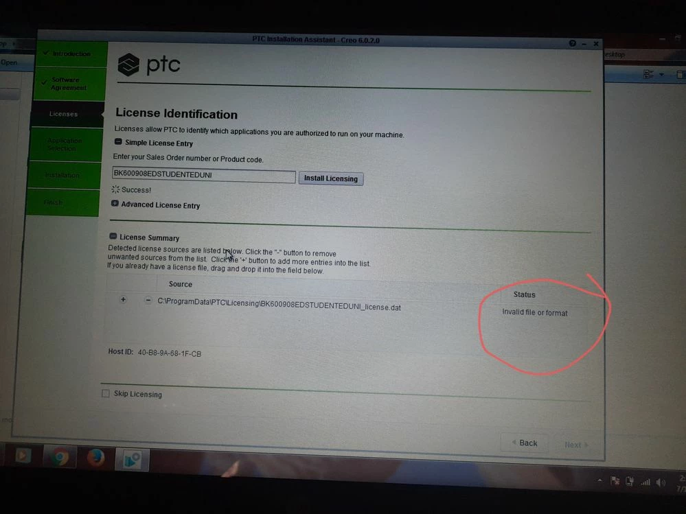

@MV_9991955 wrote:
usually this error means that BK600908EDSTUDENTEDUNI_license.dat is empty. Please verify this tip. You can also upload it to enable me to check license file contents.
Question: Do you want to use Creo 6.0 ? BK600908EDSTUDENTEDUNI code is related to this version.
If license file is empty then it usually means that installer is not able to detect network card. Please run following command from Command prompt window and upload ip.txt file.
ipconfig  /all  > ip.txt
