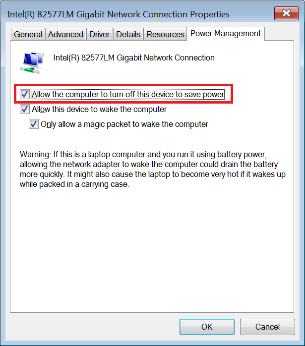

Software shows license lost massage after 15-20 min. if you are not operating it (computer going to stand by mode)
How to fix that problem?
Dec 23, 2015 11:35 AM UTC
uncheck option marked in network card properties, see example in following picture.

adeshmukh1-VisitorAuthor
Dec 23, 2015 11:40 AM UTC
Thanks.
