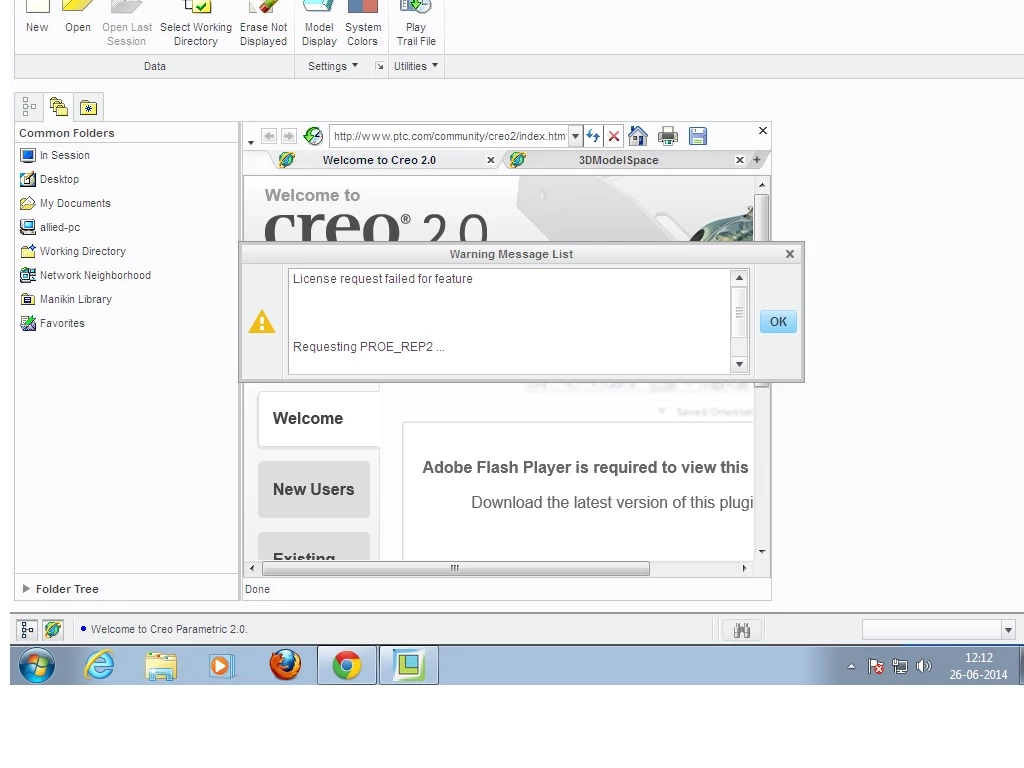

License request failed for feature.
When I try to open creo parametric this message shows up. What does it mean and how can I fix this problem?
(I have the screenshot of the message attched)
Mahesh_Sharma
22-Sapphire I
Jun 26, 2014 4:13 PM UTC
Shashi,
Error in screenshot is not clear. If you will enlarge the error window, there will be a error code.
There are some articles on PTC knowledgebase about such error messages, for example (CS21768: For error -96, CS26888: error -97, CS26559: error -4 and so on) which may help you.
For better clerification on error, add a new screenshot of complete error message.

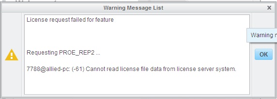

Jun 27, 2014 4:50 AM UTC
Here is the screenshot of complete message . The error code you were talking about is (-61)
Jun 27, 2014 5:43 AM UTC
Shashi,
check if license manager is installed and running on allied-pc computer. Also try to turn Windows Firewall off on that computer.
