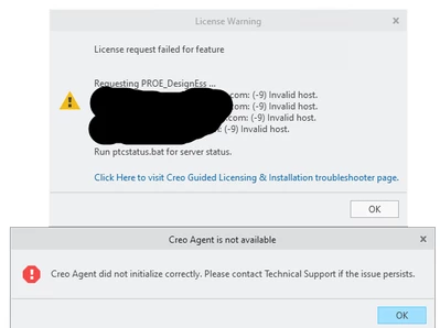

License request failed for feature
  • January 24, 2025
  • 3 replies
  • 774 views
CREO Version - 8.0.9.0
I have reconfigured CREO with Floating license but getting error as shown in attached picture.

Is this a new server for the floating license, different than the one you used for the locked license?
Did you get a new license file for the floating license server?
Creo Agent is an independent issue. Did you put the Creo Agent in a network location and not change the Creo start batch file to point to the new location?
January 25, 2025
Yes
I am just providing license server address like 7788@hostname1;7788@hostname2
I have updated in creoparametric.psf file below two points.
ENV=PTC_D_LICENSE_FILE-=
ENV=CREOPMA_FEATURE_NAME=
March 6, 2025
You need to obtain a new license for your hostname1 and hostname2 using their NIC card address. The license is tied to the network card and each installation of the license manager will require a new license file for that host.
