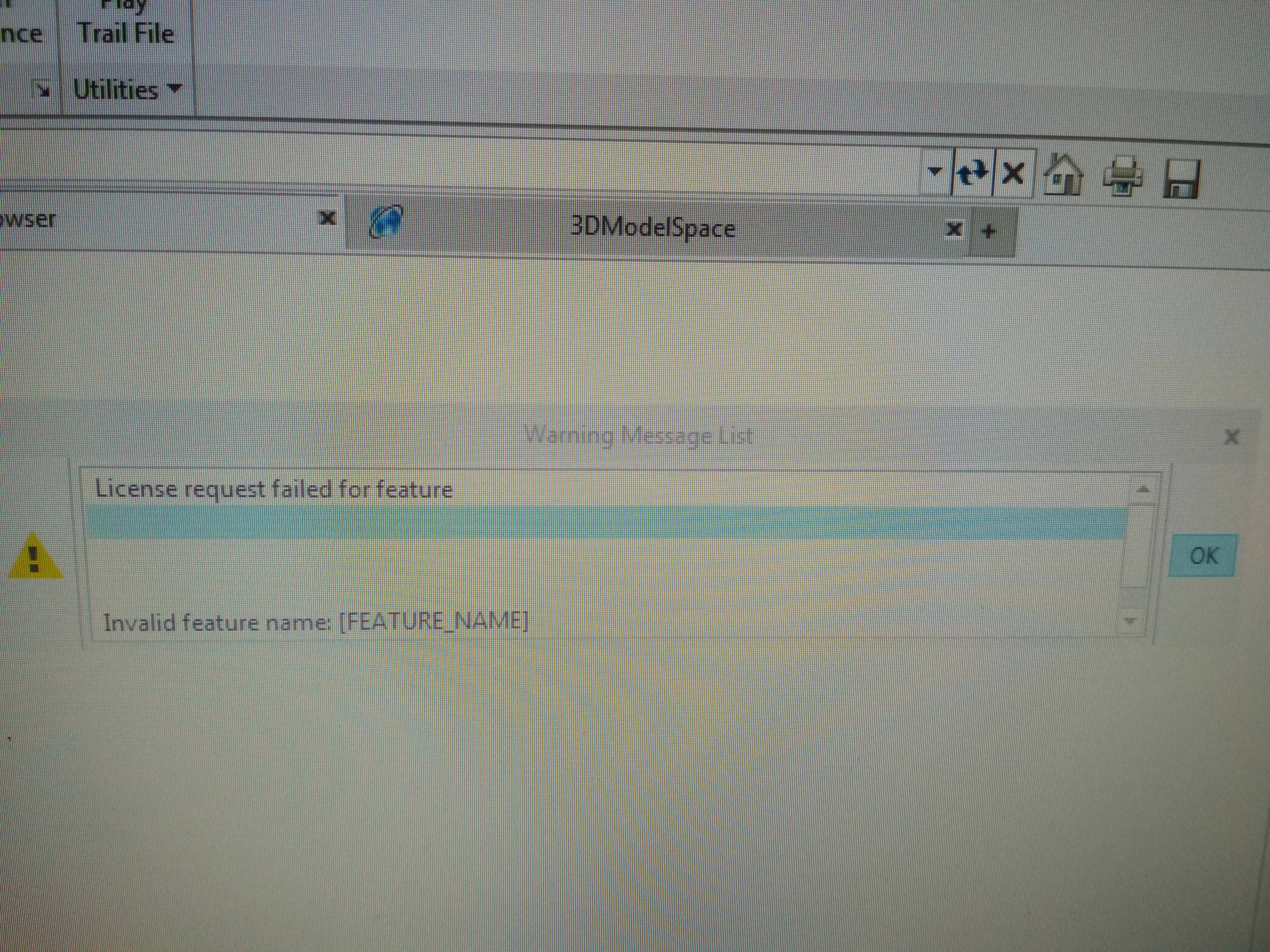

License request failed for feature
Showing these msg after opening creo but when i click ok creo software getting close automatically... Plzz help as soon as possible...

Check the article
CS198207
It is all about reconfiguration, as application is installed without license information.

Specified error is an indication of application installation without specifying license information. To correct this, execute reconfigure.exe from bin folder in installation location and specify license information on License Identification page.
