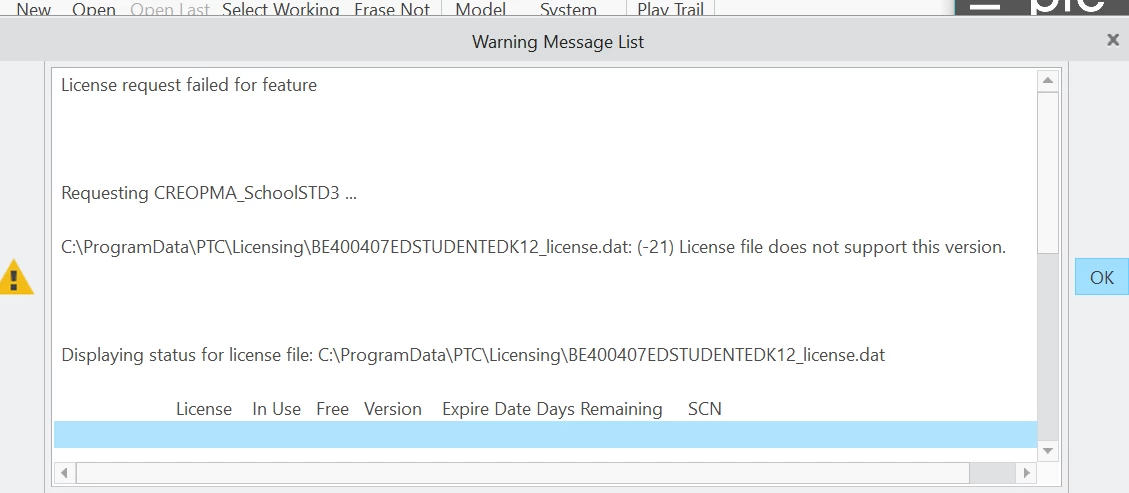

License request failed for feature
it seems that i installed CREO 4.0 for student .But there is an error when i open it.
I installed 4.0 but i found the license is 3.0. help...

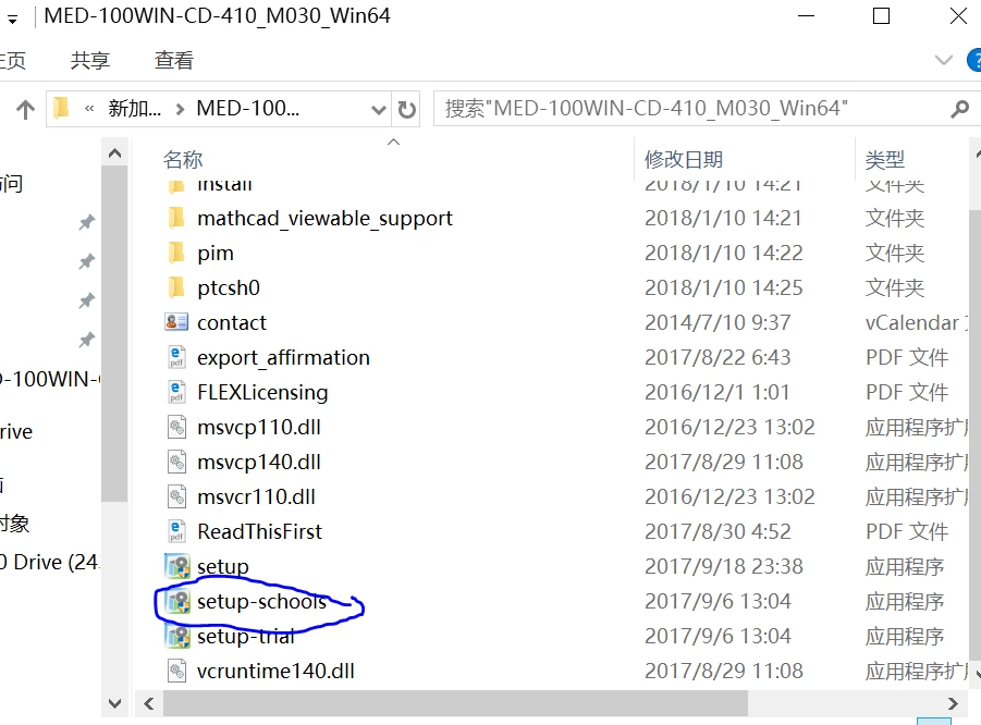

aha! I have resolved this problem. it's blame to me didn't correct the product code. the installation assistant auto filled code of 3.0. Need to fill in the code of 4.0 manually.

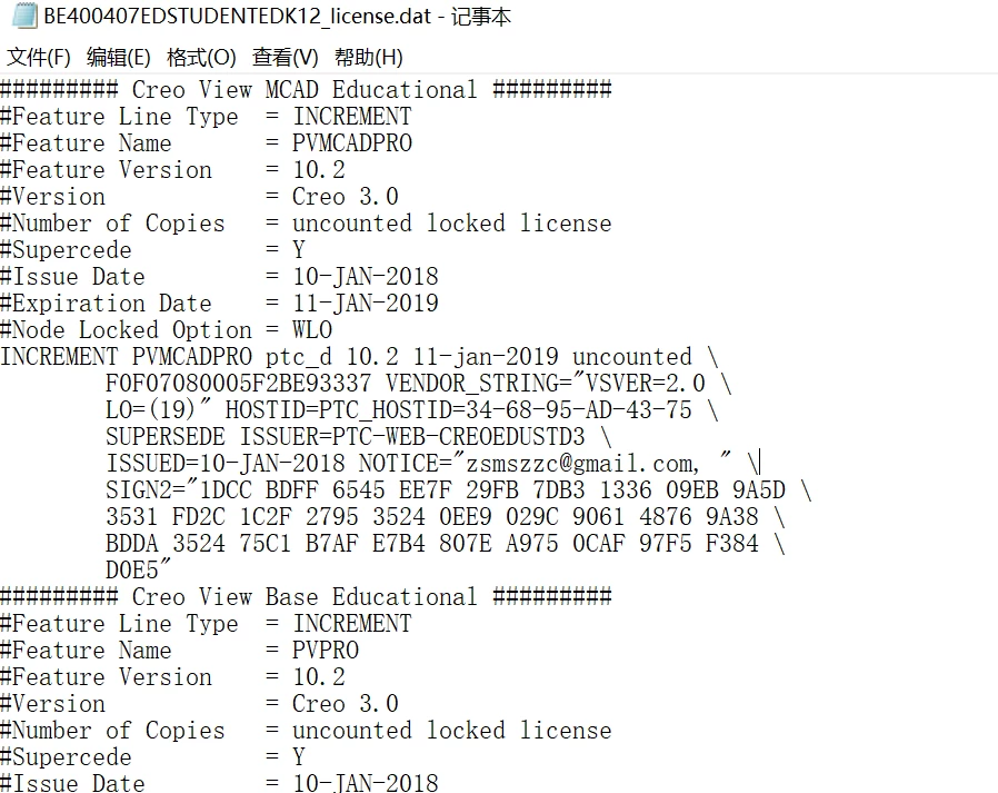

the content of the license
######### Creo View MCAD Educational #########
#Feature Line Type  = INCREMENT
#Feature Name       = PVMCADPRO
#Feature Version    = 10.2
#Version            = Creo 3.0   ??????why 3.0 ????
