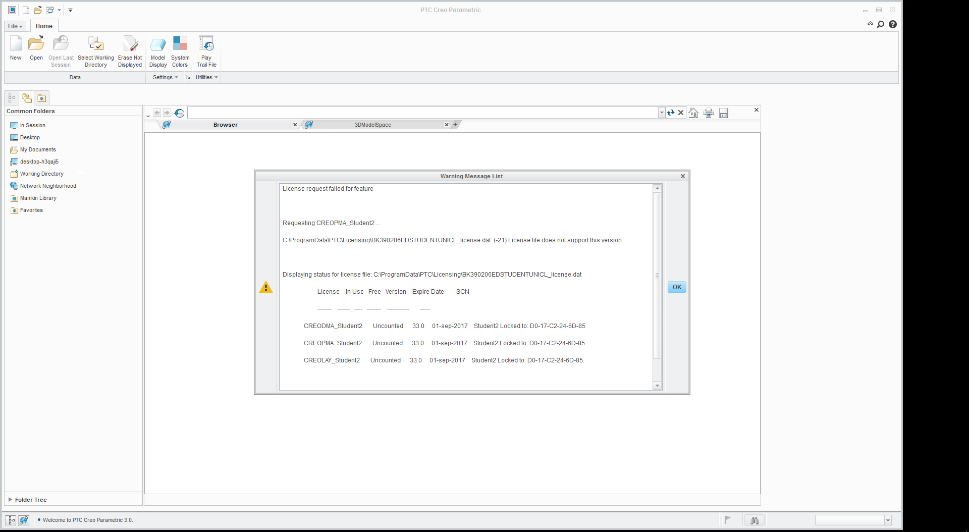

I just downloaded the student version of PTC. I only need access to Creo Parametric 3.0, but this error message comes up every time I open the program. Any help would be appreciated.ptc.PNG

Hello Olivia Riley
what l got on my mind:
1) Verifiy:  "locked to: D0-17-C2-24-6D-85" is correct... use command row and write "ipconfig /all" ...
2) "licence file does not support this version" ... is your licence.dat really student version?
Try to check it...
September 2, 2016
version 33.0 reported in error message means, that the license file does not enable you to run Creo 3.0. Version 33.0 = Creo 2.0 license file.
To be able to launch Creo Parametric 3.0, you need license version 34.0.

Reply to this post from Martin is the answer of your query. Please request for Creo 3.0 license.
You may mark Martin's reply as correct answer of the post.
