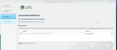

i want to install Creo6 with Win11 on an new computer. The licensfile is ok, only windows firewall is installed.
When i start the licensidentification everything looks ok, after dropping the licensfile into i get the message "is started" but after this nothing happens and no further reaction or message (also after some minutes).
What is the problem?
Thanks Alex

Problem is soved, installed C++ with older versions and opened 7788 in the firewall. Then it worked. Also Creo 6.0 runs with Win11 till now without problems.
Thanks for your helps Alex

If I remember correctly, I had this exact problem a couple of times in the past, with license server hanging on “Starting” status. The solution was to install Visual C++ Redistributable libraries, as some components were missing in the operating system.
You can check installation media for addons or prerequisites, there should be Visual C++ installers included you can use.

Basic check - Does Creo 6 run on Windows 11?
Article - CS348041 - Compatibility of Creo Parametric with Microsoft Windows 11
The answer is NO.

Just insatled Creo4 with the old licensmanager and it seems to work. With creo6 it does not work, here the licensmanager makes problems, can not get my lizens free.
