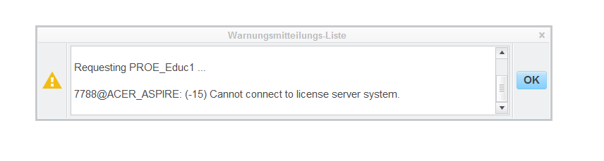

Beim Öffnen des Programmes PTC Creo Parametric erscheint ständig eine Warnungsmitteilungs-Liste mit einer Fehlermeldung (Bild unten).
Könnten Sie mir vielleicht, bezüglich diesen Fehlers, helfen ?

    Martin,
    is your computer name ACER_ASPIRE ? Or can your PC communicate via LAN with ACER_ASPIRE ?

    Thanks for your answer,
    Yes the name of my laptop is ACER_ASPIRE.

    Dec 3, 2015 7:48 AM UTC
    run services.msc applet to see list of Windows services.
    Look for one of following services and check if it is running:
    • FLEXlm server for PTC
    • lmadmin_ptc
    • locate ptclmgrd.log file in flexnet_installdir\licensing directory and check if it contains some error messages
    lmadmin_ptc
    • locate *.log files in flexnet_installdir\logs directory and check if they contain some error messages
    Upload log files for me to check.
