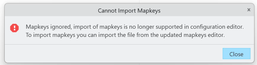

Hi
Since Creo 4 we're using toggling mapkeys.
Starting with Creo 12 the loading of mapkeys has change and is no longer possible.
Erros message from executing a toggling mapkeyErros message from executing a toggling mapkey
Any hints how our existing mapkeys could be modified?
Ziegi

I found the culprit. The loading of mapkeys from a *.pro-file is different.
Below the updated mapkey to load the temporary mapkey (sw.pro).

Feb 26, 2026 2:11 PM UTC
Article - "About error "Mapkeys ignored, import of mapkeys is no longer supported in configuration editor." in Creo Parametric": https://www.ptc.com/en/support/article/CS445938
