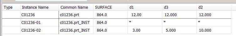

Is there a trick to get the Mass Properties to refresh in family tables.
The steps I have taken are:
1. Create a solid part BOX 12x12x12
2. Compute current mass properties
3. Regen
4. Add relation --> surface=mp_surf_area(")
5. Save
6. Create family table --> add column --> add "SURFACE" parameter and the three dimensions
7. Insert a few new instances and modify some of the dimensions
8. Verify
9. The surface area displays 864.0 for all the instance even though the dimensions are different.
[cid:image002.png@01CF3A03.AD7F2EA0]
10. Regen
11. Check the family table and the surface area values are still the same.
12. The only way I seem to be able to get it to update is to make a change to the file that requires the family table to be verified.
I also have a config.pro setting --> mass_property_calculate automatic
Is there something I'm missing?
