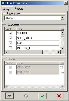

Mass Properties feature
We added a mass property feature but when we go to the Feature/Datums and want to check the "create" box for the csys_cog, it is greyed out and won't allow the pick. We used to be able to do it. Is there a config setting or some other problem?
Jun 20, 2013 7:03 PM UTC
You need the behavioral modeling extension (BMX)
