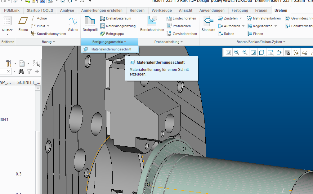

what do you need the material removal for?
When you need it as stock model for the second setup:
Click the tab "mill" or "turn" -> "Manufacturing Geometry" -> "Material Removal (cut?), then click on your nc sequence and now click "automatically".
Now you have removed the material for this nc sequence.
Do this at all your nc sequences.

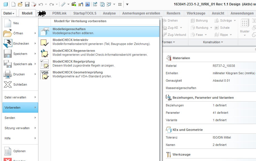

Now you have to click the tab "Model" -> "Create" -> "part" -> type in a part name -> "solid body" -> "surface" -> "copy" -> "done" -> now select the stock model in the model tree (so that all sufaces are selected) -> done.
Now you have created a part where the material is removed.
Open the part and go to "file" -> "prepare" -> "model properties" -> "accuracy" and change "relativ" to "absolut 0.01".
Save the file, start your new mfg and load this part as stock model.
I hope that this is what you looking for.

I use it because it's a habit.  I understand what you do, I didn't know that 'remove material' works, tried that in previous releases and it never worked.  I keep my 'work piece' at the bottom of my tree just for NC verification.
I'm machining multiple setups on a die cast slide, I am presently saving my 'in progress' file, 60 minutes of saving and still going file size is 1,400,000 KB and still climbing.  How is this even close to practical!  At least with Vericut I could still do something in Creo as it ran, I've wasted MANY HOURS waiting.
