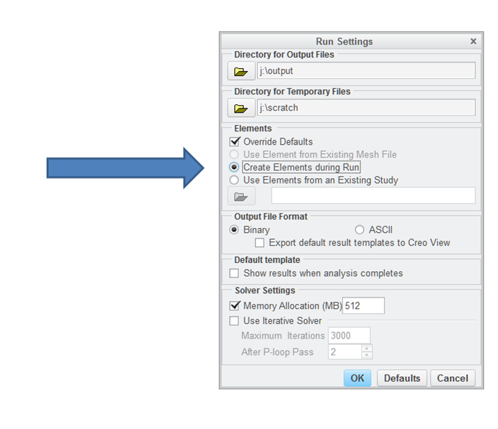

Hi TractorGuy
Tried one of these?
Aug 4, 2014 12:10 PM UTC
Tried every combination including unchecking it..still tries to create a new mesh every time.

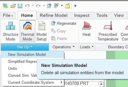

Tractorguy
Together with your results issue (it doesn't want to vcxomplete that, it looks like you are very close to having to make your simulation model again.newsimmodel.jpg
2-Explorer
Aug 4, 2014 11:40 AM UTC
Try unchecking Override Defaults in the dialog box above.
Was autogem able to create the mesh without any error messages or warnings when you manually created the mesh? If not you will need to address those issues first other wise it will continully try to fix them each time it runs the analysis.
