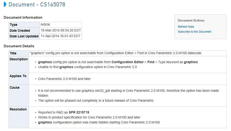

And just to confirm here, the config.pro option that was included in Gary’s link got our embedded graphics machines up and going on M100. Haven’t tried M120.
enable_opengl_fbo no
When we had run into this issue prior, we just rolled the users back to m070 (the last build that worked). We are on M100 and the integrated graphics computers appear to work with the mentioned config setting. According to the CS, though, CP2 should auto-detect the old intel drivers causing the problem and switch to fbo-->no, so maybe M120 still needs it specifically set (i.e. it isn’t auto detecting appropriately).
BK
