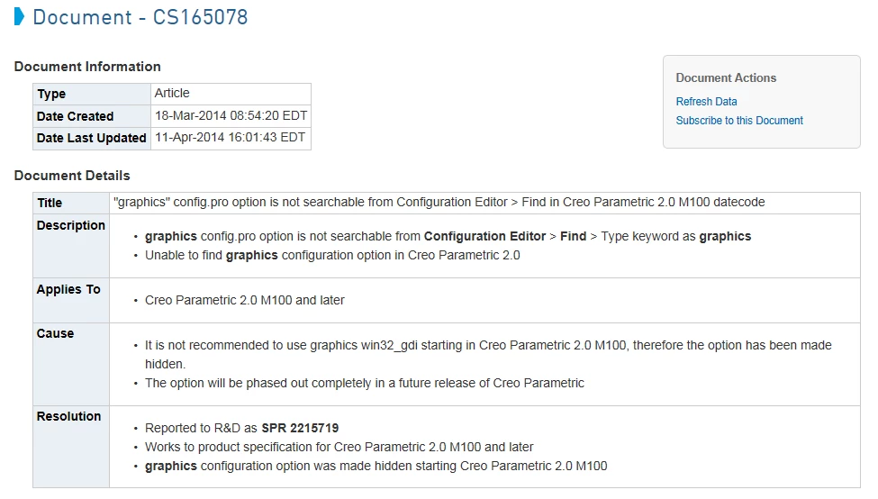

Isn’t the graphics setting deprecated or about to be? I think it’s a hidden option in CP2.0 already, no? OK, a quick search on the TS site shows that’s true:
[cid:image003.png@01CFC061.BB1A56E0]
So……with the proliferation of integrated machines, I wonder what PTC’s solution is going to be.

Wow! PTC has always told me when I had a problem to confirm that it still existed with the graphics set the win32_gdi.
It was like their safe mode, if it was broke there it was truly broke, if not it was a graphics card issue.
David Haigh
Aug 25, 2014 6:53 PM UTC
I don’t think graphics win32_gdi was ever intended to be a setting that a user would use consistently. My impression is that it was there to determine if a problem as related to the graphics card or not. If it went away when set to win32_gdi, it was related to the graphics card, if not it wasn’t.
StephenW
Aug 25, 2014 6:59 PM UTC
I just verified on Creo 2 M120 that it is hidden as the document says it is. Hmmm….
I too have used it for troubleshooting.

Ok, got it running Creo2 M120 by setting graphics to win32_gdi.
Seems to be useable.
Kind of funny & sad at the same time, but at what point do you think PTC Marketing will realize Creo2 Parametric has since been reconfigured to no longer function without graphics set to win32_gdi on the state of the art Surface Pro 3?!:
