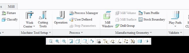

Hello Everyone! This is my first inquiry to the group. Would anyone know why our Mill Volume and Mill Surface ribbon icons would be greyed out? We are using Creo 3.0 M10. I can go into process manager and it is active and works, just not on the ribbon interface. Is there config.pro setting I need to make? I'm struggling a little going from Wildfire 2.0 to Creo 3. What a change!

I just created a new manufacturing file and the mill volume and mill surface were grayed out until i assembled a reference part. Then they became active hope this helps. I believe the ribbon is setup for to work from left to right ref model, workpiece, operation....

This is strange! Without a model assembled (ref part or workpiece), Process manager should be grayed out as well.
Maybe a specific license / license missing?

Hey Guys, thanks for responding. @nick, I see what you are saying, looks as though you are correct with the left to right process. As a side note,I did have a reference part set and have quite a large program going on with about different 200 tool paths, and still it will not show up as it did in Wildfire. As gkoch said, it should be greyed out in both areas. Guess we can chalk it up to more inconsistency with the new interface. For now I am using process manager for making up my mill surfs and such.
