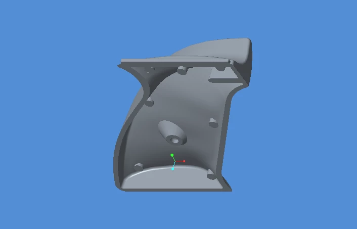

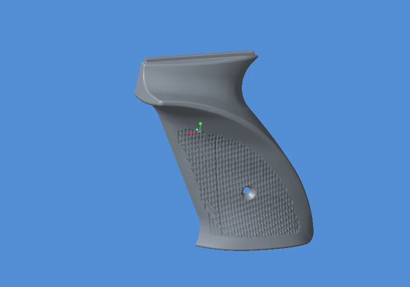

I am attempting to create a mirror of the part shown in the attached image and it keeps aborting.  I have tried changing the accuracy to different settings with no success.  Any ideas would be greatly appreciated.

Thank you for your quick response Kenneth.  I am using Creo 3.0 and attempting to create a mirror image of the shown right handed grip to create a left handed grip.  I will try using your method.  When I tried it I just tried to do a "save as" and selected mirror image.

My guess it is your texture pattern.  Suppress that stuff on the grip then try the mirror from the save as menu.  It looks like something is going wrong where your tip of your pinky finger would be as it wrapped around.  Your pattern does not look complete at that point.
You may need to mirror it then re apply texture to your mirrored part.

Thank you to both Ron and Stephen.  Ron's answer was correct in that the texture pattern was what was creating the problem.  It mirrored successfully when I suppressed it.  The problem now is that the part is an inherited part and the texturing is above my current capabilities of recreating.
Stephens solution seemed to work great in that the part created was successful.  I suppressed the original part and the results look like just what I need.  But now I need to save as a .stl file and it won't successfully save.  The part won't triangulate.  I'm needing an stl to submit to a 3D printer.

drawlins1-VisitorAuthor
March 2, 2017
That will work Ron.  I had to suppress a couple of rounds at the top of the part to get it to work but then it successfully saved as stl.  And yes, I'm able to print a mirror image on the printer.  Thanks to all for your help.
