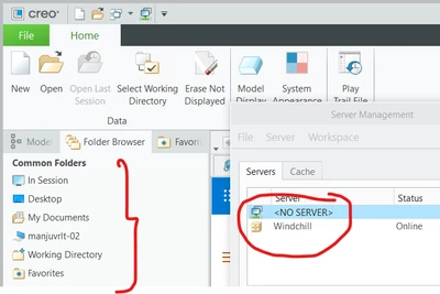

One of our users has lost the Workspace line in his Common Folders tab.
Does anyone know what he may have done to lose it and what can we do to get it back?
He can still get to his files with the Home icon and then open his workspace in the browser, but using the shortcut in the Common Folders tab is faster.
Sep 24, 2021 3:30 PM UTC

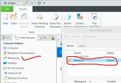

Check if the user has mapped to a Windchill server in Creo - Server Management
