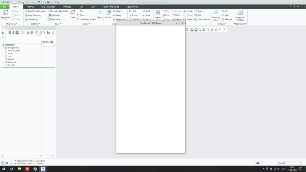

My model check report is coming up blank.
I only use it for overall size of part.

    Hi @harshad_iCAD,
    This may happen due to write access to generate the reports. You may create a new folder (may be in C:\temp) and set that as the value of DIR_REPORT in config_init.mc.
    https://www.ptc.com/en/support/article/cs375984
    I hope this will help.
    Oct 15, 2022 11:32 AM UTC
    Image for reference .
