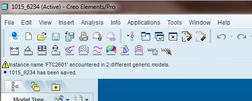

Another "Wild West" mode question:
In the line of text, I have an error message that "pops" up. A certain model (i.e. model block1234.prt) has been reference in two generics. Is there a way to find out what the generics are so that I can clean this up?

Dale_Rosema
Sep 21, 2012 3:32 PM UTC
I thought maybe a picture would help.
Any thoughts?
Sep 22, 2012 9:06 AM UTC
looks like you have two generics with family table in working dir or search paths which contain the same instance name.

Dale_Rosema
Sep 25, 2012 8:19 PM UTC
If so, how can I tell which ones have it?
Sep 26, 2012 6:36 AM UTC
do a text search in the .idx files in each folder
