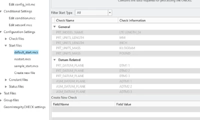

I am using Creo Parametric Release 9.0 and Datecode9.0.0.0
Totally new to Creo. Trying to open up the ability to edit the configuration settings in ModelCHECK (Check Files, Start Files, etc.) so that we can create custom defaults- currently these options are greyed out. Can these settings be unlocked or what is the procedure to accomplish this? Thanks!

The first thing I do is copy the ModelCheck (mdlchk) folder to a common network location.
The files under the text folder can be edited with any editor.

Thanks for the reply Ben.
So I have created a copy of the modchk folder and changed the path. Does this look correct to you? Should the config files now be editable within Creo, as shown? or do we need to edit them outside of Creo?

Youi should be able to edit them from Creo, if you are in the admin 'group' of ModelCheck. You do NOT want all users to be able to edit the ModelCheck files. Personally, I edit the files with Notepad outside of Creo.
