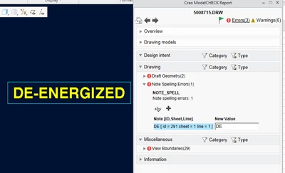

ModelCHECK (MC) is returning an error that I don't know how to get rid of.  In the user_words we have the lines:
DE-ENERGIZED
DE-ENERGIZE
DE-ENERGIZES
Yet, Creo is returning DE as a spelling error.  Does anyone know how to not return an error when it is part of an acceptable hyphenated word?

I tried quotes using "" and '' and neither of them work.  I did some more tests and *think* what is actually happening is that it is ignoring the hypen, treating the dash/hypen as a space and then checking both words individually to see if in the dictionary.  This is not at all what I want so am going to open a ticket.

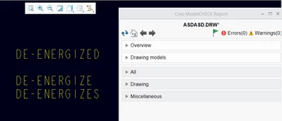

I added the words ENERGIZED, ENERGIZE and ENERGIZES; MC did not flag them as spell error.

@manjunathrv you must also have DE added to your dictionary then too right? I think this is @LawrenceS's point - he doesn't want to add DE to the dictionary.

@manjunathrv , thanks for the test, however, @Chris3 is right.  There is no question whether the user_words dictionary works without hyphenated words so if you wanted to test what I am trying to do you have to add the entire hyphenated words:
DE-ENERGIZE
DE-ENERGIZED
DE-ENERGIZE
