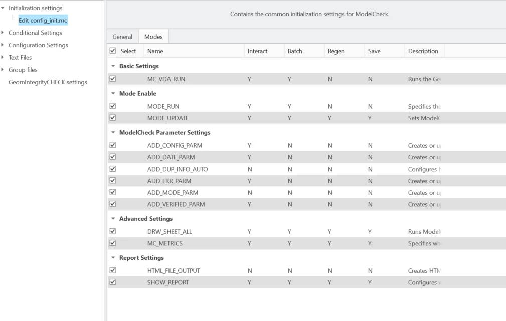

Modelcheck is not running properly. i have the files setup. (config_init.mc... and others). i have also enabled modelcheck in the config edit as well that the Modelcheck_dir. I have also enable show_reports. (see attached pic).  When I run Modelcheck interactive, it completes the process but does not display the modelcheck screen.

Are you getting any ModelCHECK related information in message log of Creo?
You may try using ModelCHECK with default configuration (don't set any ModelCHECK related config) to confirm it is not a config related issue.
