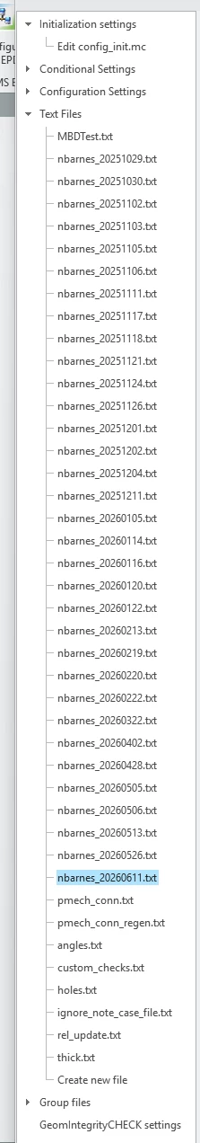

I’m trying to figure out where the metrics files are being written.
It looks like files are being written somewhere.   But Windows 11 search is terrible, so it can’t fine files I can see with my eyes.
I have the config_init.mc option set as follows.
  • DIR_METRICS    C:\ptc\mc_out\mc_metrics
  • DIR_METRICS_NT C:\ptc\mc_out\mc_metrics
  • DIR_REPORT_NT    C:\ptc\mc_out\mc_report (This works, so I know I have write permission)
Image from ModelCHECK configuration tool shows files are being written somewhere.  (probably)

Unless configured in the config_init.mc they are written to:
C:\Users\<user>\AppData\Roaming\PTC\ProENGINEER\mdlchk
If you use batch mode, you will also see status and logs in:
C:\ProgramData\

Thanks for the tip.   I found the files in the files in the start-in directory, which for us is in another local location.   Also, I removed and re-added the location from the config file using the configuration tool, and only set mc_metrics and removed  references to legacy mc_metrics_nt configurations.   Now its finally working as expected.
