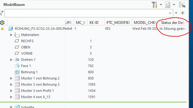

I would like to use the "Workspace state" of objects as trigger/check in the conditions file.
Anyone knows if this is usable and knows the internal attribute name to write in the conditions file?
Screenshot only in german available.
Thank you for the help
Marc
Background info - our prefered mode is interactive
We try to not use the regenerate mode due to model state in session gets changed and people are then more confused with the WC state column in Creo 6 -
Thats the reason why we are looking to read out the state "checked out".
In one check round we use the "PTC_MODIFIED" EQ YES to start the checks, but if the Objects is only checked out and has not changed it is still not modified.
