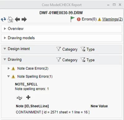

Has anyone else noticed that sometimes ModelCheck will flag a word as misspelled even though it is in the user_words dictionary file? I even cut and pasted the word from the ModelCheck results flagging it as an error into the user_words file and the next run it gets flagged again as misspelled. The word is CONTAINMENT.
We are running Creo 9.0.5.0.

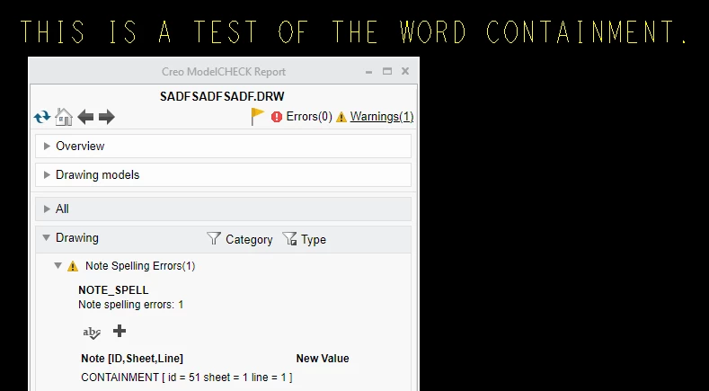

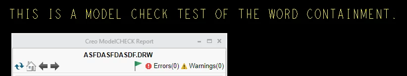

Did you restart Creo? I am pretty sure user words get loaded in upon start and don't get reloaded until you restart.
Without in the user words:
In the user words (after a restart):

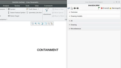

I tested 9.0.7
February 7, 2024
I did try this same word in Creo 7090 and it worked fine. Thought this word was flagged at first, after adding to user_words, and rerunning MC interactive, it was not flagged. Restart of Creo is not required after adding words to user_words.
February 7, 2024
Update: I tried the same in Creo 10.0.1.0, and the word was correctly spelled and was not flagged by MC interactive.
