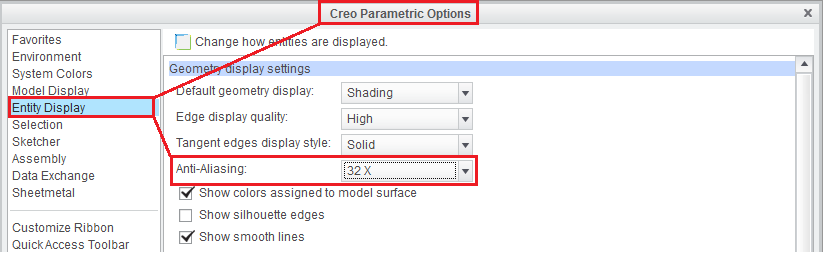

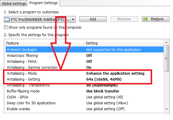

What are your Video card settings for 1.) Antialiasing - Mode and 2.) Antialiasing Setting
1.) Change these video card settings for antialiasing and ­restart Creo.
2.) Then in your Creo options make sure Anti-Aliasing is not off. I increase quality to max 32X for work sessions. If I am just retrieving large assemblies this is off. (config option “enable_fsaa”)
Should see increased GPU usage with these settings.

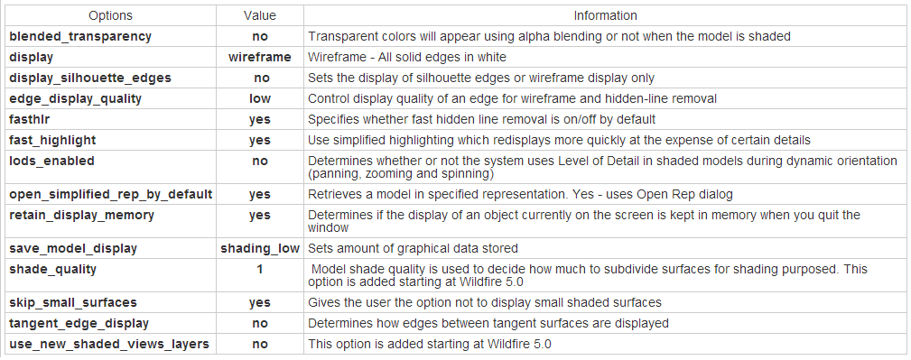

I would start with these three:
shade_quality
edge_display_quality
smooth_lines
October 12, 2015
Here is what I have:
shade_quality     3
edge_display_quality     normal
smooth_lines     no

See: CS52452 How to improve performance for large assembly by decreasing display quality in Pro/ENGINEER, Creo Elements/Pro and Creo Parametricconfig_options_cs52452.png
October 21, 2015
I tried all of these options and they provided no improvement at all.
