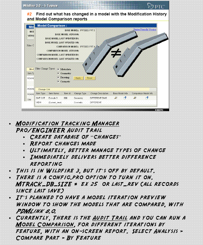

Does anyone use this or know anything about it other than what is on the attachment? I found on Olaf's site the config option is listed as hidden but I can't find any reference for this feature anywhere else.
