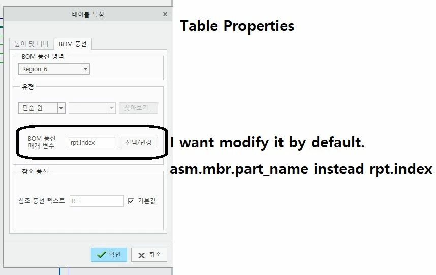

I have sent a same topic.. But it looks lost. I send you again.
when I make the BOM baloon. I want to change the default value rpt.index to the other one in table properties.
anyway I want to show you the picture.
    Best answer by MartinHanak
    @Yunny(Yunko_KR) wrote:
    I can modify that click the select and change... if I can, I want to know set it by default value..
    Anyway thank you for interest of my question.
    1.]
    You cannot set asm.mbr.part_name as default value used for creation of any new repeat region.
    2.]
    You can create repeat region, set asm.mbr.part_name as BOM value, save table into .tbl file and import this file into new drawing when you need it.
    3.]
    You can create drawing format -OR- drawing template, place the needed repeat region table into it and use this format/template when new drawing is created.

    please publish a picture explaining your request.
    3-Newcomer
    March 30, 2023
