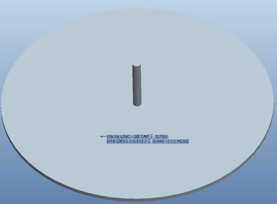

My colleague is trying to modify the default information that pops up in the note when you create a hole using the hole tool. The note properties look like this
"&METRIC_SIZE &THREAD_SERIES - &THREAD_CLASS &STD_HOLE_TYPE &VAR_THREAD &THREAD_DEPTH
&NUMBER_SIZE DRILL ( &DIAMETER ) &VAR_DEPTH &DRILL_DEPTH -( &PATTERN_NO ) HOLE"
My colleague wants to know where the system pulls that information from so that he can edit the information that pops into the note by default.

I'm actually looking for where this information is saved in the pro/e folder so that when a hole is created only the information I want to show up in the note, shows up. So it's beyond modifying anything in the pro/e interface.
