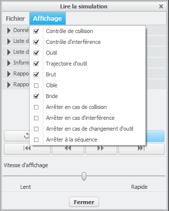

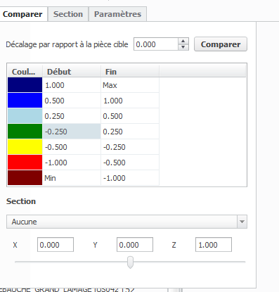

Is it possible to save the settings we like in Moduleworks. I mean, for example setting different default values for comparison fonction. The defaut values are really to wide for me.
And also the settings in the playing interface.

Look under the Parametres tab. There are buttons to save and load an xml settings file.
How many settings does that preserve I'm not sure. Don't have ModuleWorks installed at the moment.

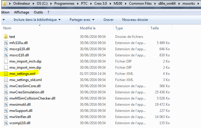

RaphMORIN16-PearlAuthor
Jul 1, 2016 12:39 PM UTC
Thanks James, it works. It looks like it saves all the settings of the 3 moduleworks tabs.
In order to get these settings by default I replaced the original file in the location below :
