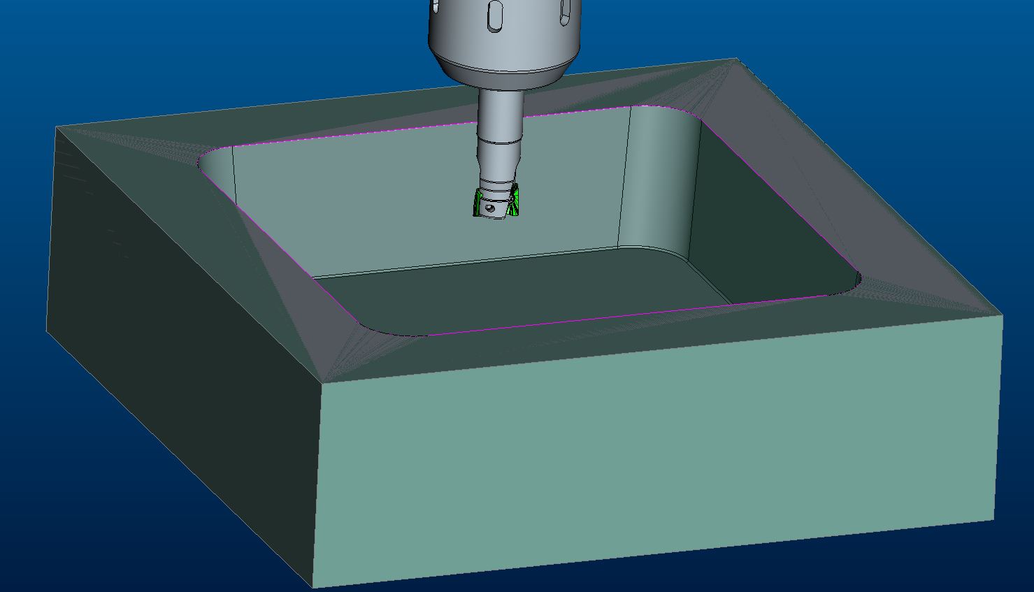

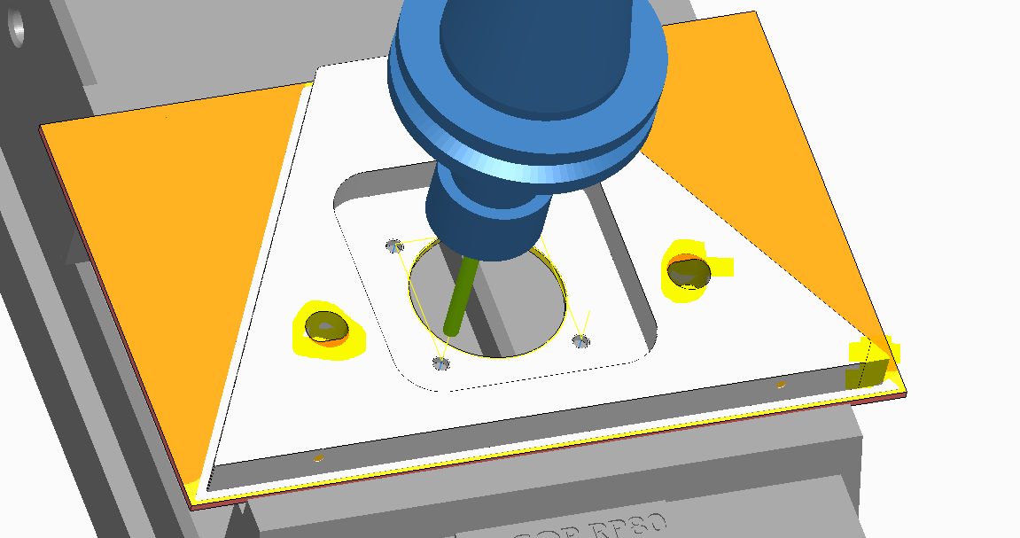

Sorry you are still having problems with Module works. They fixed my problem where my ball end mills looked like chamfer tools with M110 but now I discovered a new problem with it. Some imported tool assemblies don't show up in Moduleworks. Not sure why I am still investigating it.
Play path image
Module works image
The biggest problem I have with module works is it is slow to show the cuts. I have all the settings in ModuleWorks set to the lowest quality and it still takes forever.
Not sure if it's my work which is small and very fine detail or if it's my computer. Personally I think it's ModuleWorks.
