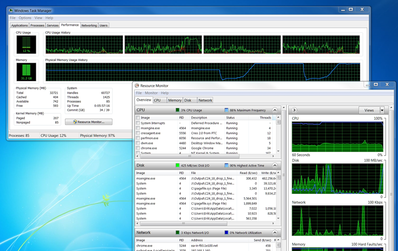

Can PTC please report on plans to break the 32Gb memory barrier, It's been predicted for a while now, but I would like to know when to order the extra memory.
I run fairly big models, that could do with a bit more memory (look at the picture, 32 Gb in use, 425 Mb/s disk i/o on my SSD).
Thanks.

Thanks for your information, but in (large FE models) this works differently:
1: When the model gets big, not all the matrices will fit in memory, the Stiffness matrix gets partitioned and parts of it are placed on the hard drive (scratch) this seriously reduces performance compared to running the full model "in core'
The high disk i/o rate shown means the software is swapping data blocks form memory to disk and back. a normal harddrive would not get highet than approx 80 Mb / sec. this already reaches 500Mb/s. but is still a limit for the cpu, which can't run at 100% for lack of data.
2: For some types of analysis, the memory limit will limit the model size, for this type of analysis it means that if you require more than 32 Gbyte, the analysis will simply not run (message: the analysis requires an extra xxx Gb of memory to complete).
this is a shame, because the memory limit is (no longer) caused by the windows 64 bit OS. It is a limition in the simulate software which can and should be removed.

Did my analysis just use 37 Gbyte?
I've moved to Creo 3.0 M060, it looks like somebody moved the 32 Gbyte limit while we weren't watching, or am I mistaken:
Look at my summary file: That's 37Gb in the line with Maximum Memory Usage
Machine Type: Windows 7 64 Service Pack 1
  RAM Allocation for Solver (megabytes): 512.0
  Total Elapsed Time (seconds): 19670.67
  Total CPU Time    (seconds): 20739.46
  Maximum Memory Usage (kilobytes): 37260651
  Working Directory Disk Usage (kilobytes): 1003520
If I see this correct: Thanks PTC

What i intended to post is different: Whatever you did with Solram, 32 Gb was to be the absolute maximum in memory that Simulate could address, be it physical memory, or using swap space.
The discussion here has been to ask PTC to raise the 32 Gb ceiling to a higher value.
As I've shown in the reproduction of part of the summary file is that it seems that PTC has done it (my analysis used 37 Gb, which was hitherto impossible, the analysis would have stopped with the fatal message that "the system was requesting an additional memory of ... Gb" which was not possible.
Now with Creo 3.0 M060, it just did it.
Good news i think.
