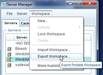

    This is from PTC tech support when we needed to do this:
    Mike Foster
    ATK
    You cannot move the workspace by moving the Cache folder to the target machine, please use the "Export Workspace" command as explained below.
    1. Go to Tools -> Server Manager
    2. Select or activate the workspace you want to export
    3. From the Workspace pulldown menu select Export Workspace
    [cid:image001.png@01CCD02F.2B3E3840]
    4. Exporting workspace will create a .pws file (Portable WorkSpace) click on the "Browse" button to save it on the local disk
    5. Click OK
    6. Give a password and confirm the same
    7. A PWS file get saved on the location you specified
    8. Copy it to your target machine and use the Import Workspace command to import the objects
