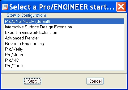

Jul 12, 2011 8:45 PM UTC
You might want to look at my talk "ProE Admin 101" I gave at PTCUser 2010.
It addresses how to reserve specific licenses for individual users, and how to setup multiple license configurations for the users to pick from when starting ProE.
The user would see a menu like this, showing all the different licenses available:
[cid:image001.jpg@01CC4099.D16CBC80]
You set up these choices by adding additional License Configurations when installing ProE.
