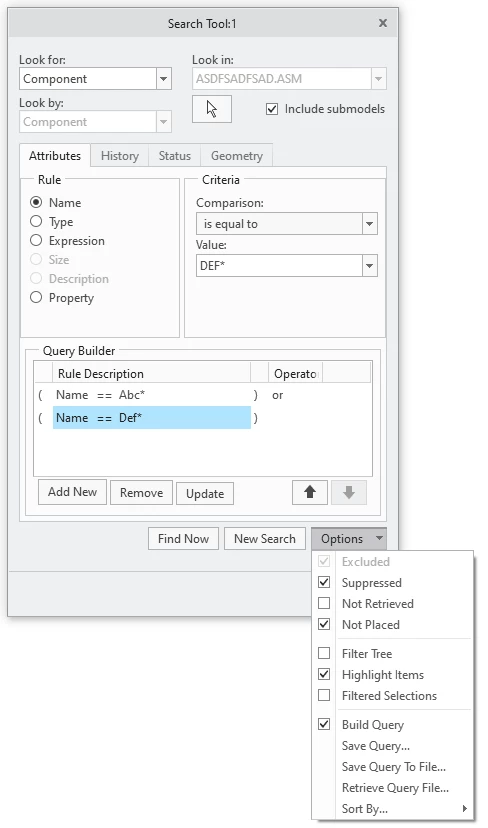

In Creo Parametric, is there a way to search/filter the model tree for a list of part numbers at once instead of searching for part numbers one at a time?
In Creo View there is a "Multiple Search Values" option where you can search for a list of part numbers at once.
In Windchill there is "OR" Boolean logic that uses a semicolon ";" to allow the search of multiple part numbers.

Yes, you can use the find tool (CTRL-F). Make sure to select Build Query from the options and then you can use the AND and OR operators to narrow down what it is you are looking for.
