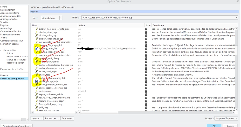

My configuration don't reach the good libraries on windchill
I am using Creo Parametric Release 6.0 and Datecode6.0.4.0
We have a business configuration and Winchill as PLM (PDM). In our configuration we point to our libraries (our libraries are on windchill). We have, for example, libraries for our drawing template. But when I create a new drawing care don't reach the libraries we ask in the configuration, we reach the standard PTC libraries.
This issue starts one day with no explication, I'm the only user who has this issue and we tried some re-install and install on an other computer but nothing change.

    The config option that controls the location of the templates includes the name of your Windchill server.  Double check that the name given in Creo matches the name given in the config file.  If these don't match, Creo will default back to it's built-in ones.  The name is case sensitive.

    The issue was exactly what Tom describ , My server name have been modify ( i don't know why), so i correct it and it's ok.
    But i've still a small issue, my drawing configuration still not fonction. I will check all the path again. But what 's the different beetween the different symbol int the configuration panel ? ( the magic wand, the lighting beam  and the small computer)

    The icon to the left of each option indicates whether a change is applied immediately, or on the next startup. The lightning icon means immediate effect. The wand icon means the change is applied to the next object created. The screen icon means the change is applied in the next session.

    Ok thank you very much. So my drawing set-up's charge when I open a new draw ( in theory). I checked all my path for this but every seems to be good so I don’t understand why I can’t upload my drawing drawing set-up's.  The best solution I found is a macro ... 😄
