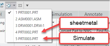

I typically open a new file in each mode so I can do edits on all of them by switching between the files.

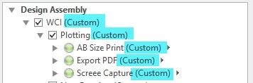

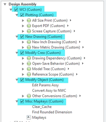

The groups are named consistently between the modes so the UI become familiar to the users.
  • Plotting – all modes
  • New Drawing– all modes
  • Bom’s & Stamps – Drawing mode only
  • Modify Creo– all modes – This group is for modifying how Creo Behaves
  • Modify Object– all modes – This group if for modifying the file on-screen
  • Detail Setup – Drawing mode only
  • Misc Mapkeys– all modes
Cascades – I won’t list them, but they are similar in the different modes for consistency
Picks – Depending on how Creo operates the mapkeys may be unique to the mode or common to all modes

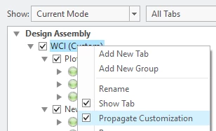

For each Tab, and Group you have to be sure and uncheck Propagate Customization before you start editing the current ribbon file.
For the assembly mode, I have to do this 6 time. In Drawing mode 8 times.
At least this appears to be saved with the ribbon file once you do it.
