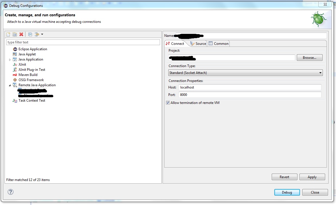

2.Even if create a java file with start& stop methods, I'm not able to debug in eclipse (mars) with jdk 1.8 for creo 2.0..after setting debug configuration in eclipse.. I got VM refused error..but I did registered my protk.DAT file with creo & java_jlink_command within java.exe-****8000***..still no luck..so how to dubug exactly in eclipse/netbeans?
It looks like you know something about specifying debugging options in your java.exe command. I know only one way to do that, and that is to specify the java.exe command in the environment variable PRO_JAVA_COMMAND.  This is what I use:
C:\Program Files\Creo 3.0\M050\Common Files\x86e_win64\obj\JRE\bin\java.exe -Xdebug -Xrunjdwp:transport=dt_socket,server=y,suspend=n,address=8000
Make sure you use the same settings in your IDE.

2.Above image is showing my Debug configuration Settings.

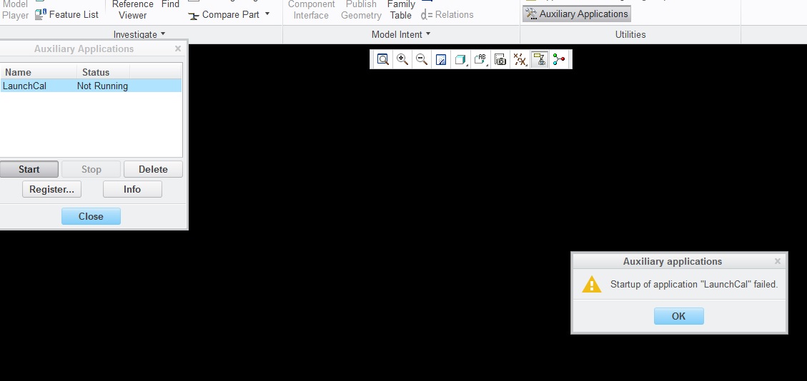

4.After that  ,i changed the environment variables as you suggested ,name -PRO_JAVA_COMMAND value- C:\Program Files\Java\jre1.8.0_60\bin\java.exe-Xdebug -Xrunjdwp:transport=dt_socket,server=y,suspend=n,address=8000.
5.Then i changed the protk.dat location & deleted jlink_java_command in configuration editor..after that clicked Auxiliary Applications in utilities to register the program..
then i clicked start button ,i got this error

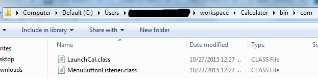

my class path C:\Users\xxxxx\workspace\Calculator\bin\com

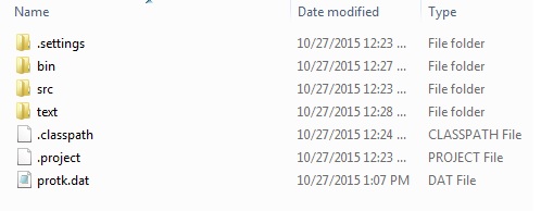

This is my Folder structure
So kindly help me ..where exactly i'm making mistake...Thank you

Again, there are many reasons why your application isn't launching.  Here are a few things you should check:
  1. Your java_app_classpath is most likely incorrect. Try adding \bin to the end of it.
  2. Do you have pfc.jar referenced anywhere in your CLASSPATH?  You can do this in the CLASSPATH environment variable or in java_app_classpath line.  I have noticed that java_app_classpath does have a limit to the number of characters it supports, so I put only the application's folder or .jar file there.
  3. You shouldn't declare start, stop or OnCommand with throws jxthrowable .  You need to write a try/catch block to handle those exceptions.
  4. You need a better package for your program than simply "com". You could try "com.prakash" for now.
