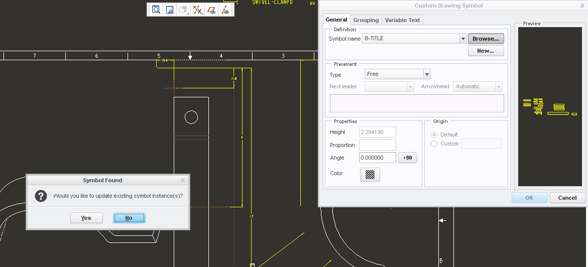

I'm trying to update our API 12F symbol to our company standards, and I can't seem to open the symbol to do so.  I can access it in any DWG,  but it won't save the changes from one to the next.

Once a symbol has been added to a drawing, the definition is kept within the drawing. The general rule has always been to not have drawings update standard items unless the user specifically does it.
You probably have a symbol library that you would need to go to and correct the symbol, then WRITE (save) the symbol back to that location. Then when you change a drawing, you would need to re-add the symbol and manually replace it.

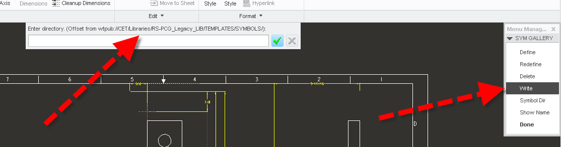

Thanks. You're right - I do have a library of symbols, but it won't let me access it outside of a DWG.  I can't seem to permanently change the symbol in the library so I can even just replace it in each DWG manually.  At this point, I have to redefine the API 12F symbol each time I open an different DWG, rather than simply replacing it.

Once you've redefined the symbol, you have to WRITE the symbol to save it to your library. Or save it to your hard drive then copy it back to the library (depending on where your library is).
And as Matthew says, if you then pull up your new symbol (same name), it gives you the option to update it.

What you can do is set up a dbatch job to iterate over the desired drawings and update each, by: retrieving it; getting the new symbol definition from the disk, choosing to update existing instances; saving the drawing.
