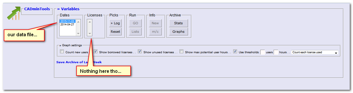

Does anyone have any tricks that they can share about getting EDWIN MUIRHEAD‌ 's great license tracker utility up and running?   We have it installed and it is gathering data every 10 minutes,  but the data is not showing up on the webpages.
Other info:
  • We are less than a week into this exercise, so have not run the license archive utility yet...
  • Ran through the set up and have web pages showing
  • Do have a partial set of users entered.
  • Have the server information entered.

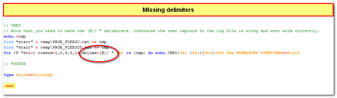

  • Ran through the license logging set up and created the lic_log.bat file...
  • data is accumulating

The two things that seemed to be holding us up were:
  • a missing temp folder
  • some missing delimiters in a for statement in the lic_log.bat file.
The missing temp folder needed to be created under the log folder.
The missing delimiters were:
