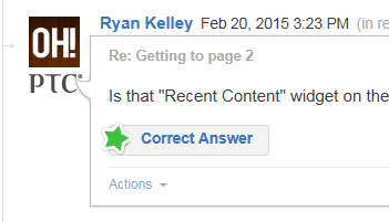

Mahesh, I am unable to find a place to mark a reply as correct.
Dale_Rosema
May 29, 2015 6:08 PM UTC
On the various replies, there should be a box below each answer. Just click on the one you want.
